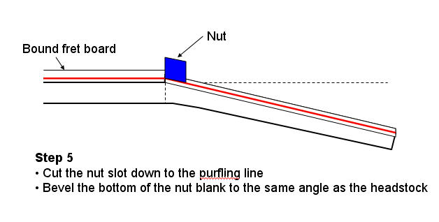

This is how the fingerboard stop works. It effectively lowers the fingerboard in relation to the face of the headstock, allowing the headstock binding to be the same height as the fingerboard binding, which in turn allows the side purflings to meet up.

Get a look at Benedetto. As far as I know that is the only book which even mentions the problem, which is to get enough room for the side purflings to continue under the nut (where the bindings will stop for a break. Benedetto, however is not very clear in his description or drawings. The stop is glued to the plane of the neck that the board will be on, and its effect is to extend the plane of the headstock over that part of the board, thus setting the nut (which will rest on the stop) a little lower into the headstock face. The nut will have the headstock angle cut on its bottom. So initially, before installing the stop, the plane that the board will be on should go at least 3/16" beyond the end of the board; 1/4" is better. When you are all done, looking from the side, the plane of the neck under the board will appear to end at the end of the board.
A thicker headstock veneer will also give you more room for your binding and side purfling.
When you look at Benedetto, the above will, I hope, make sense.
And bind your headstock before you glue the fingerboard on. Don't ask my why I know this.
[edit] uh-oh. What John does is the opposite of what I do, and why I found Benedetto misleading. But I have to run now, I'll check in later.Howard Klepper39092.6004398148

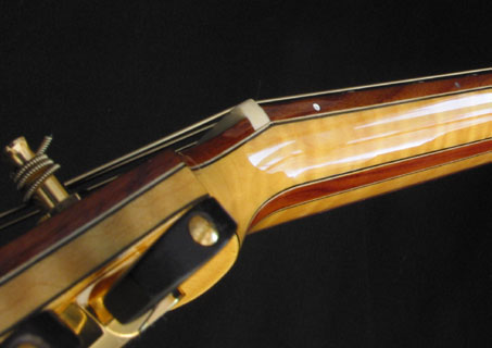

JJ, I think I'm a ways off from "guru", but here's that same guitar finished.

John...That's what I'm talking about! Absolutely gorgeous.
You're too modest...I've never seen anybody who makes complex necks better...or even attempts such complexity! Very inspiring

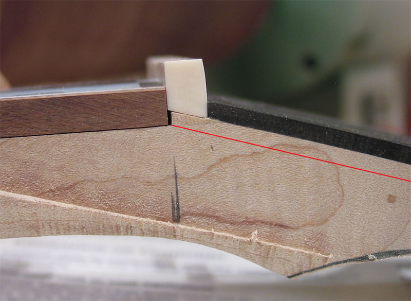

I have simplified this step. A picture says more than words so here it is.

If you do it as in John How's photo (nice looking git, John), you will not get a continuous line of side purfling, because of the lap over of the board purfling with the headstock purfling. Avoiding that is the point of the fingerboard stop.
JJ, I always do (2) before (1), above. When you use the stop, you will initially layout the point where the headstock plane begins as if the nut is going to rest on the fingerboard plane. After the stop is installed, the nut will be on the headstock plane, which is extended over the stop.

PostPosted: Fri Jan 12, 2007 10:58 pm

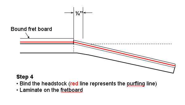

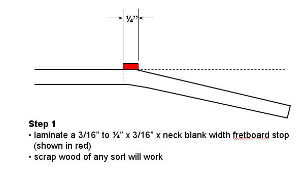

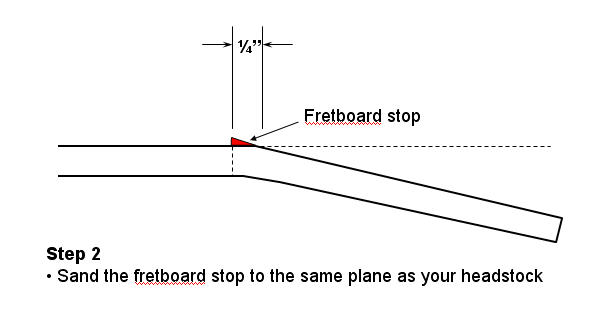

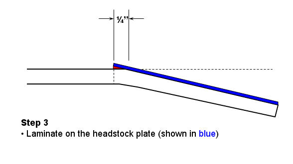

Here are the steps JJ was referring to in the email sent that will result in a nut installment as shown in John Watkin's second posted picture.
[/IMG]
Anthony Z39095.293275463
PostPosted: Sat Jan 13, 2007 2:16 am
That was a tremendous help, Anthony...thanks. It's now in my reference book for the next opportunity.
